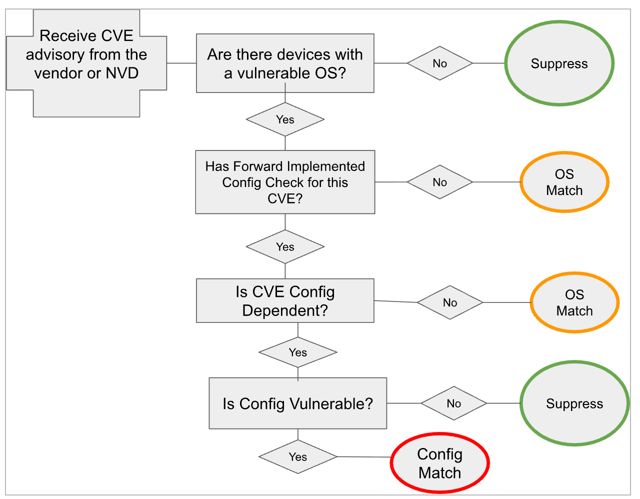

While the vast improvement over the generic vulnerability scanners, the older implementation of Forward Networks vulnerability detection had certain ambiguities. Specifically, the devices identified as having OS Match vulnerabilities could be vulnerable because the vulnerabilities in their OSes were always present, regardless of the configuration or possibly vulnerable, because Forward Networks has not yet implemented configuration analysis for those operating system or the configuration analysis did not complete. Further, Forward Networks treated equally the patched devices with  OSes that did not have any known CVEs and the devices with vulnerable OSes but not vulnerable configurations by omitting both from the CVE list. Differentiating between these two cases would have helped with upgrade planning and results comparison between Forward networks and other vulnerability scanners.
In the Forward App versions up to 25.3, the CVE detection decision tree is as follows:

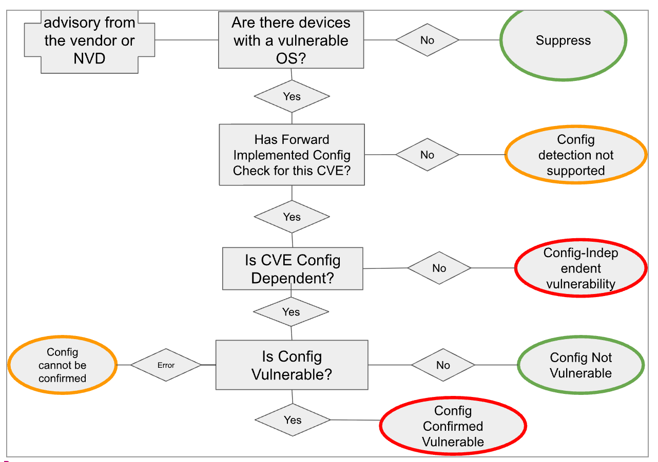

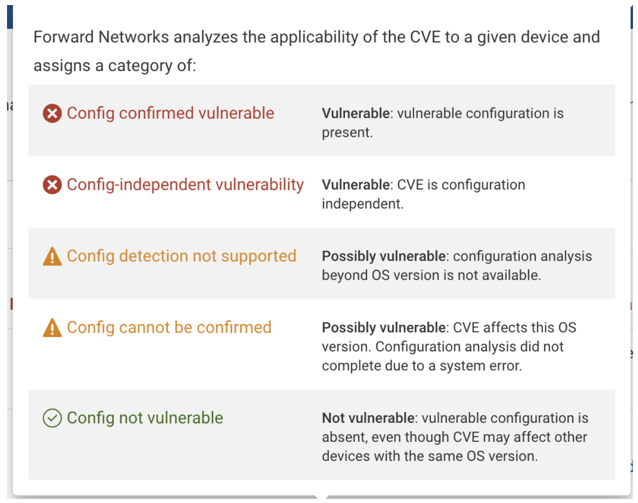

Release 25.4 addresses all of the above issues by making the CVE detection status more precise. Rather than two statuses, OS Match and Config Match, the new release publishes five detection statuses: Conig Confirmed Vulnerable (Vulnerable), Config-Independent Vulnerability (Vulnerable) , Config detection not supported (Possibly vulnerable), Config cannot be confirmed (Possibly vulnerable), and Config not vulnerable (Not vulnerable in the current configuration).
CVEs that affect no operating systems found in customer environments are not listed. This decision was made for two reasons:
  1. It would introduce a lot of irrelevant information into the product. For example, CVEs that only affect IOS would never affect any network devices. There is no reason to mention them.
  2. It would bloat both the Forward CVE database and the UI with hundreds of pages non-actionable CVEs.
On the contrary, including the CVEs that affect devices with the same OS, but not affect certain devices in their existing configuration is helpful because:
  1. It help reconcile the results from black-both vulnerability scanners like Qualys or Tenable that produce results only on the basis of the OS version
  2. It helps identify devices that could become vulnerable after a relatively minor configuration change.
Here is a decision diagram for the new detection:
