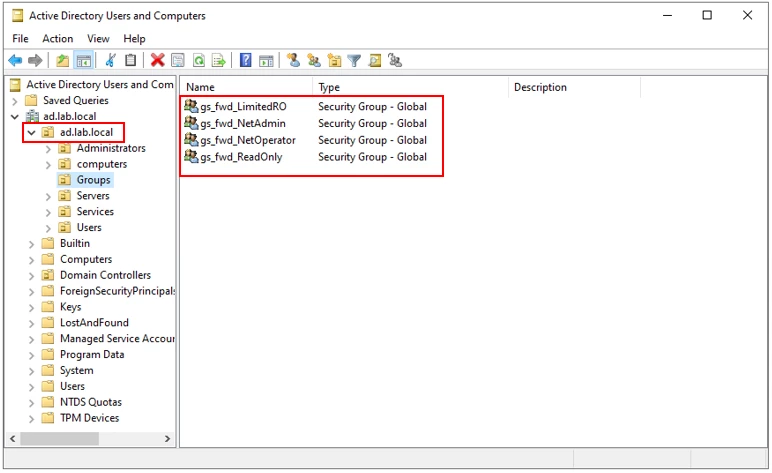

To set these groups up within ADUC:
Â
Select a location to create your security groups. In this example the groups are already created, but this details the process of creating a security group. If you already have a security groups OU structure, you can skip this step.
Right-click in the right pane of ADUC. Select New → Group
Â
Ensure that the Security radial button and Global radial button are selected. Give your security group a name.
Â
Â
Once completed, it will look similar to the picture above.Â
NOTE that the OU that these security groups belong to is ad.lab.local. This needs to be represented in Base DN for the LDAP connection.
Â
These security groups from Active directory are mapped to groups within the forward platform.
Â

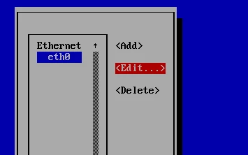

Confirm if there are any other DNS servers that should be referenced. If there are, they can be added using nmtui and adding the additional nameserver:
Â
Â
Edit the connection:
Â
Edit the adapter
Â
Â
Add the DNS server.
Editing the resolv.conf will work, but the entry may go away with a reboot.Â
