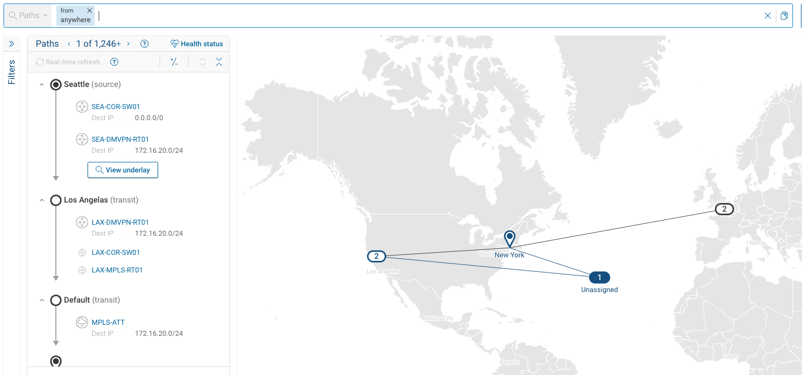

  1. Perform your intended path search using your specific parameters.’AD_4nXeFFhcbu5BpOuOH4mRQk78oQig3J6CjpaovdcDJV_pfLqEBPh1S5viZ6V2JQkh1l196vGSgeDJexdK90rntM2VPt-Y8rOXXMtFkoom3wg1LxnJtH9JRdU2xipqiVIKY3BKVYBe4?key=BbdxrBK2OJX1BEGZBgcBsPGG
  2. From the search results, you can see off to the right a copy icon. This allows you to copy path search syntax. It also allows you to export your existing path search to  snapshot.AD_4nXeu5a1Twt185wBjRwVwsK5HGw16p4VWogGxC4NQ_rbZDUGPKkDBYjdpeeeVE4tcFq6M2z8_sG54mQ_tNmrE8Q1xxmn3udGvZ5z8wwXcrnKRWLD4JDx0IjYAGsD-Y6MH_8zrt6ykrA?key=BbdxrBK2OJX1BEGZBgcBsPGG

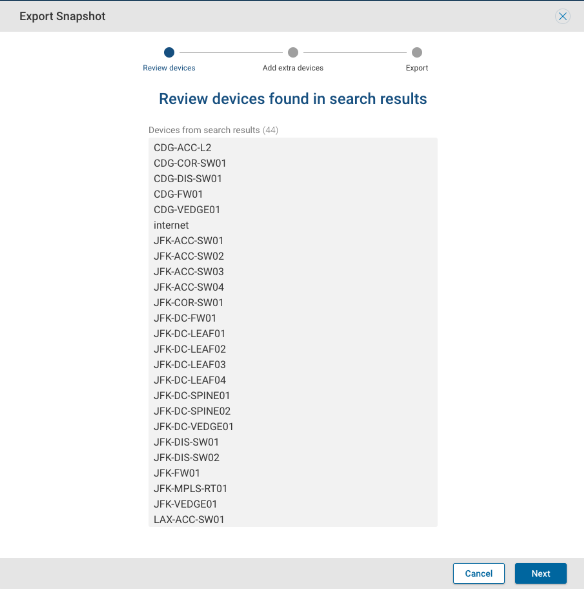

  4. This should bring up the “Export Snapshot” creation window. As you can see, it will automatically grab the devices associated with the original path search. You can review this list and make adjustments after clicking Next.AD_4nXffYvqxdAluyFpxcaAXYb5rfshWpoSqO3BCKFDbK1g68vQwUp1EuHRzGeL3TvqIDM2fO37kRtah5F1io_mzArlhG50rYMTePjKfLfr0m6mgWIyf_9LpTtI2dEUKQoWcUy99zivylg?key=BbdxrBK2OJX1BEGZBgcBsPGG
  5. After clicking next as explained in the prior step, you can add additional devices here that you would like to add to the original list of devices associated with the original path search. Click Next to continue and finalize the Export.AD_4nXffYvqxdAluyFpxcaAXYb5rfshWpoSqO3BCKFDbK1g68vQwUp1EuHRzGeL3TvqIDM2fO37kRtah5F1io_mzArlhG50rYMTePjKfLfr0m6mgWIyf_9LpTtI2dEUKQoWcUy99zivylg?key=BbdxrBK2OJX1BEGZBgcBsPGG
