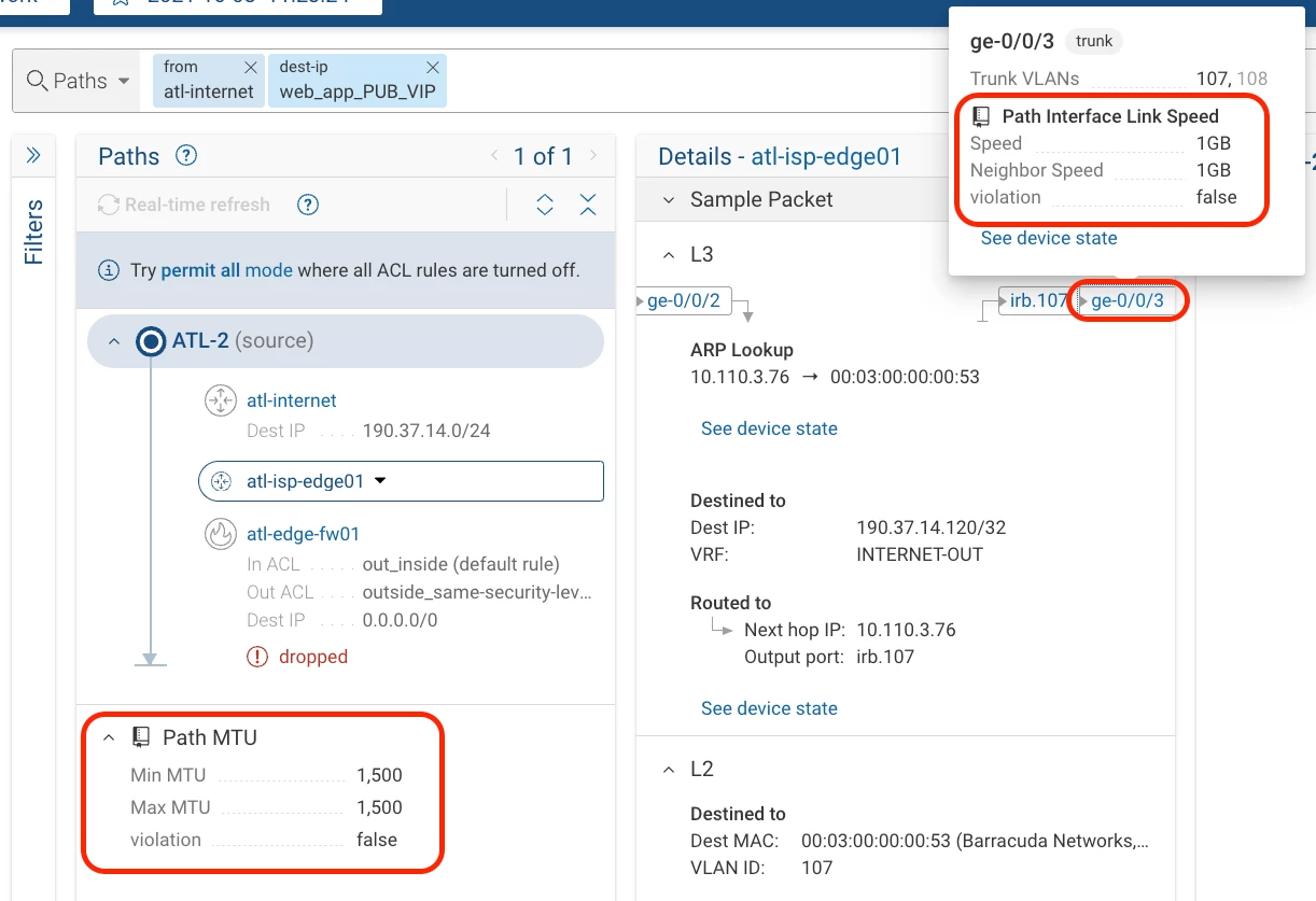

In the following  path search result, you can see two Decorators. There is a Path Decorator that calculates the Min and Max MTU along the entire path, as well as a Path Interface Decorator that displays the Link Speed. (The user must click on interface ge-0/0/3 in the Details card to see the Interface Decorator).

To create a Path or Path Interface Decorator, you have to create a Parameterized NQE query that takes in a Path parameter. The NQE query then iterates over the hops in the path to perform its calculations. For example, by using foreach hop in path.hops below:

In the Path Interface Link Speed query (/Forward Library/Interfaces/Path Interface Link Speed), a table of interface speeds is created per hop. In this example, the Hop Index is associated with the hopIndex column to create the Path Interface Decorator.
In the Path MTU query (/Forward Library/Interfaces/Path MTU) the minimum and maximum MTU for the path are calculated.
Note the @query getPathMtuInfo(path: Path) function. This function is used to convert this query into a Parameterized Query, which takes a Path as an argument.

When associating an NQE query with an Path Decorator, notice that there is no Join Columns field, because the query results are applied at the Path card level, and the Parameterized NQE query takes that Path as an argument.
