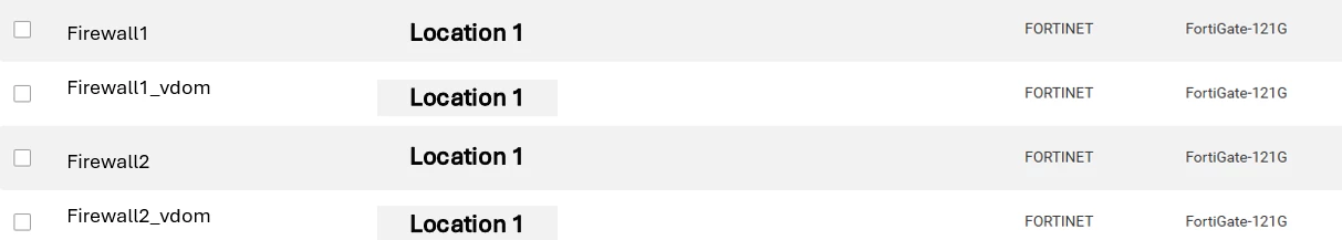

​@Tyson Henrie The issue is that for Fortinets the physical device and root vdom are one device and then any additional VDOMs are separate devices, we only have the tacacs configured in either the root domain or the VDOM for which
Device Example from the inventory
So if we look at this example if “Firewall1” and therefore the root VDOM had the tacacs configuration then Firewall1_vdom which does not have tacacs configuration would fail, even though as a physical device it has Tacacs configured.
In the same token if “Firewall2_vdom” had the tacacs configuration then “Firewall2” would fail the check even though the physical device has tacacs configured and is therefore compliant.
I think I might have a solution and will work on it today, if it works I will share, but in the mean time if anyone has any ideas, would gratefully appreciate it 😀
